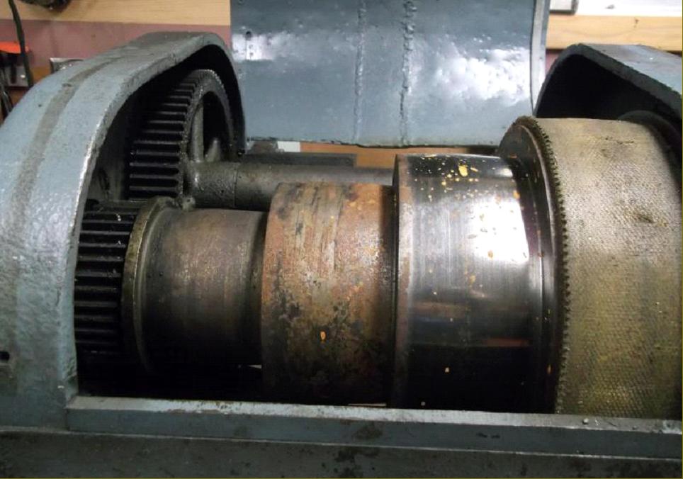

 Running in Timken taper roller bearings clamped in place by massive 4-bolt caps, the spindle had a 3.5" x 6 t.p.i. threaded nose with a No. 5 Morse taper socket and carried a wide, 3-step cone pulley for drive by a flat belt.

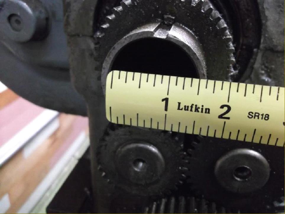

 Driven through an external tumble-reverse assembly, the proper Norton-type, quick-change, twin-tumbler screwcutting and feeds gearbox provided a range of pitches from 2 to 112 t.p.i. - the usual reversible quadrant gear being fitted that gave a choice of coarse or fine feeds by being reversed on its stud.

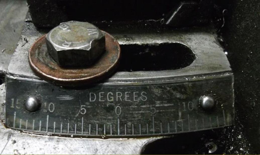

Production numbers must have been limited for, instead of engraved or rolled-in digits on the various feed dials, these (and those on the tailstock spindle) were hand stamped.
