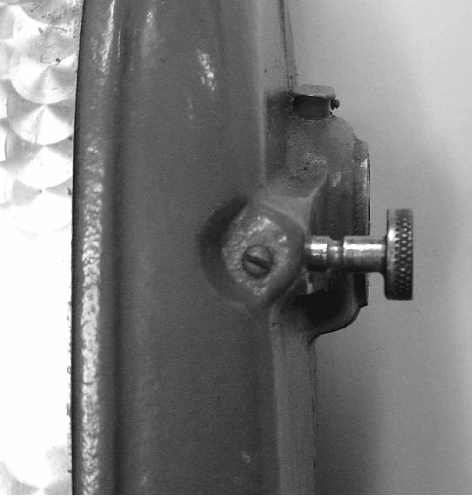

Pin (P) to connect and disconnect Bull Wheel and V-pulley. Instead of a pin, some lathes use a stud and nut arrangement - or even a quick-release fitting.

The backgear is a clever but essentially simple mechanism probably conceived around 1817 by Richard Roberts, an English engineer and prolific inventor. If you have to read the following several time to understand how it works, don't worry, everybody does…. In the picture above (a 1934 Atlas lathe) the 4-step V-pulley (V) has a small gear (SG) permanently attached to its smaller end. The entire length of V-pulley and gear are bushed - and able to rotate freely on the headstock spindle. The large "Bull Wheel" (BW) is keyed or held to the spindle with some sort of through-bolt or grub screw and always rotates with it. It can be connected to the V-pulley - and disconnected from it - by a pin (P) which is often spring-loaded, or by a nut and stud arrangement or some sort of quick-release fastening. In normal use the V-pulley is rotated by the drive belt and the spindle turned through the action of the pin driving the Bull Wheel and hence the spindle to which it is connected. To engage backgear the lathe is stopped, the pin (P) withdrawn (leaving the pulley and small gear free to rotate) and the Backgear (BG) rotated on its eccentric shaft to bring it into mesh with the other gears. On starting the lathe the action is now as follows: the pulley is rotated by the drive belt with the small gear (SG) on the V-pulley (V) driving the larger of the two rear-mounted backgears - which in turn causes the smaller gear at the other end of its shaft to rotate. This smaller gear drives the Bull Wheel (B) , and hence the spindle at a much lower speed (normally in the order of a 6 : 1 reduction) but with greatly increased torque. *If, instead of a pin, a bolt head is found, slacken this just sufficiently so that it can be pushed downwards to disengage the bolt that holds the bull-wheel and pulley together. If the nut is removed the pin may fall to the inside, requiring the whole headstock assembly to be dismantled in order to recover it. Examination of the headstock pulley and the backgear shaft may well reveal the presence of oil holes; these are important for, when working in backgear, considerable forces are being transmitted and the whole assembly requires frequent lubrication if it is to work reliably. If the pulley is allowed to seize on the headstock spindle considerable time - and possibly money - will have to be spent in order to free it off. Not all backgears engage like the one above: some, like the one on the 1906 Drummond illustrated below, are just slide into position while others are held in a forked bracket with operating lever and also slide sideways. Some are even built into the larger end of the headstock pulley and operate on a "epicyclic" principle, not unlike that of a Sturmey-Archer hub gear on a bicycle (an epicyclic backgear arrangement is shown lower down the page). There is often a small mark on the pulley to show where the pin, that passes through the bull wheel, will engage (if this is missing, one could, with advantage, be scribed or punched). The face of the pulley is often not a simple, flat surface but hollowed out with a small drilled boss provided to carry the pin; if just pushed in at random and the lathe started, the pin will catch on the side of the boss and bend. If your backgear constantly jumps out of engagement there may be an adjustable friction screw with a locknut, hidden away at the back of the casting, that will bear against the shaft..
