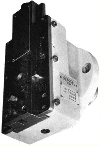

Type FNCj Slotting Head, a unit able to be inclined 45° each side of vertical and with a maximum tool travel of 80 mm in 12 rates of stroke that varied from 18 to 224 per minute.
