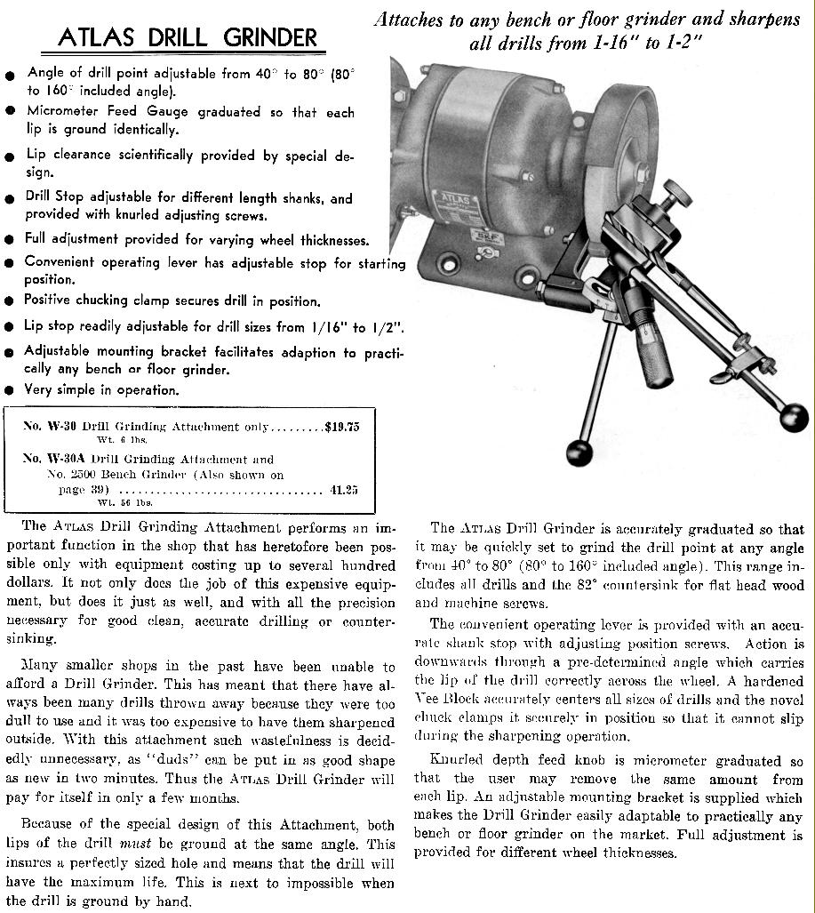

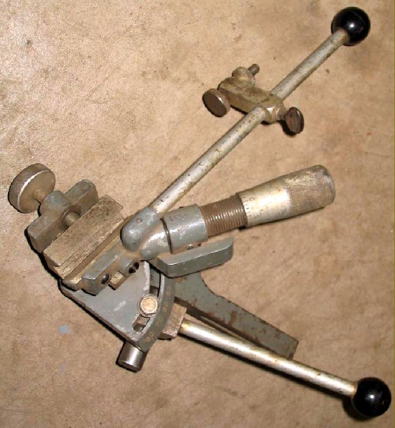

Listed for the first time in the Atlas "All-models Catalog" for circa 1935 (the second edition of such), the Atlas drill grinding attachment followed an established design as produced by a number of other makers and was offered in a single size designed to sharpen drills from 3/32 to 1/2" in diameter. Also branded for the Atlas-manufactured "Craftsman" range,  although limited in its capacity, the Atlas had one rather superior feature: "micrometer" adjustment of the feed gauge that ensured each lip of a drill was ground accurately. The matching unit offered in the UK was originally by a Company called Reliance - and constructed in a similar fashion using all steel and iron parts.

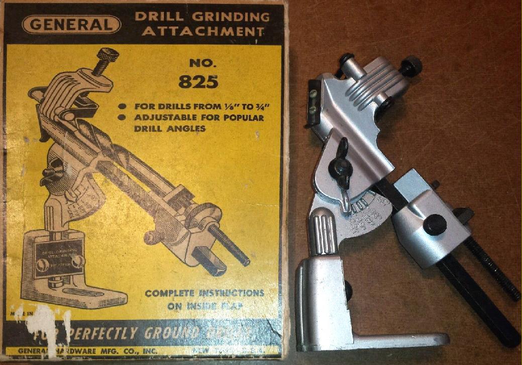

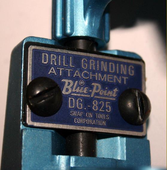

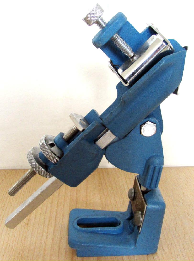

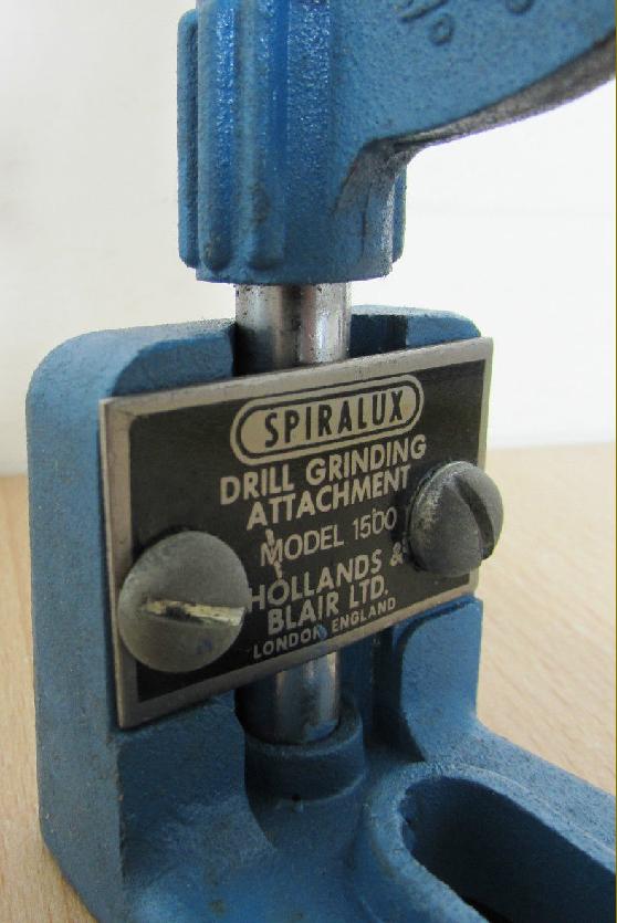

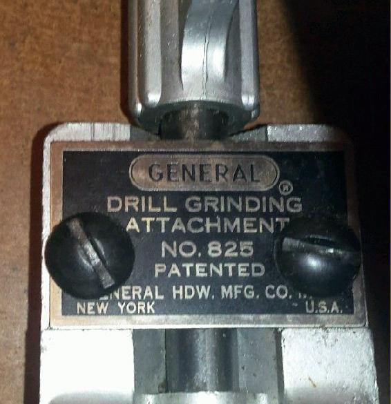

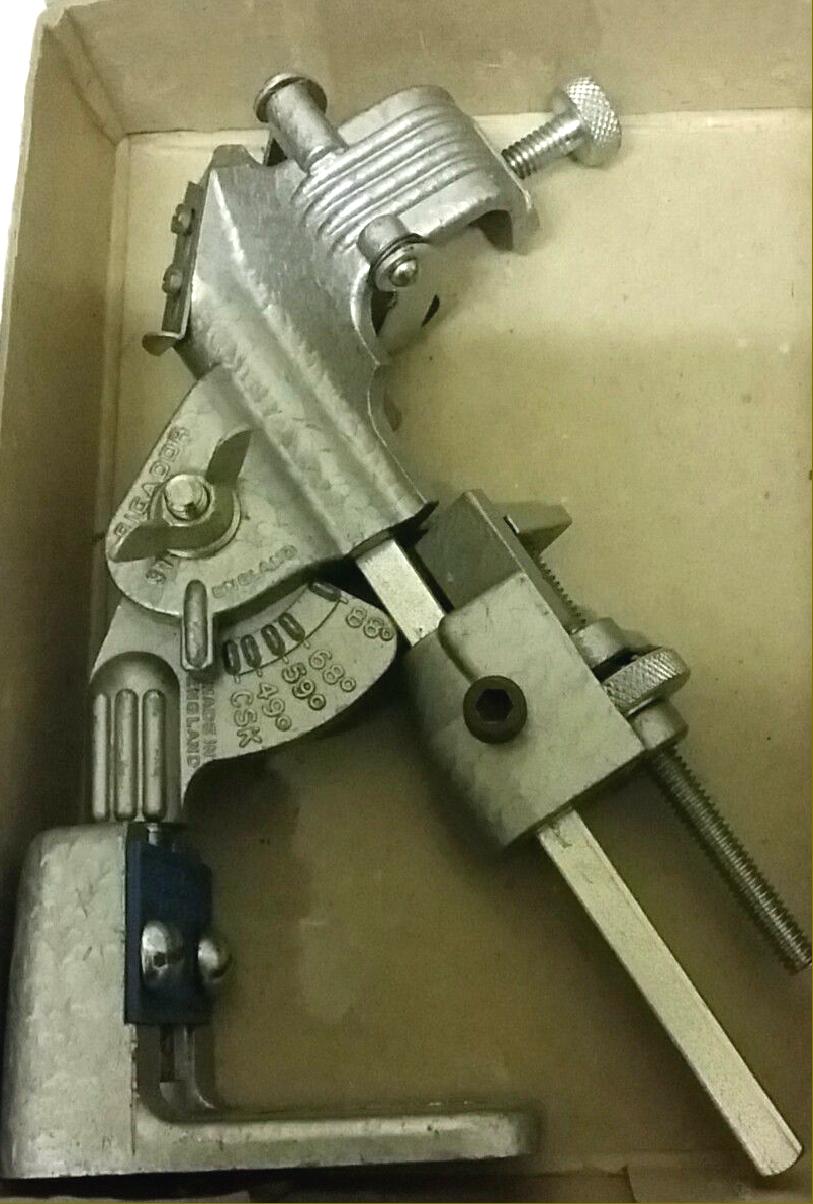

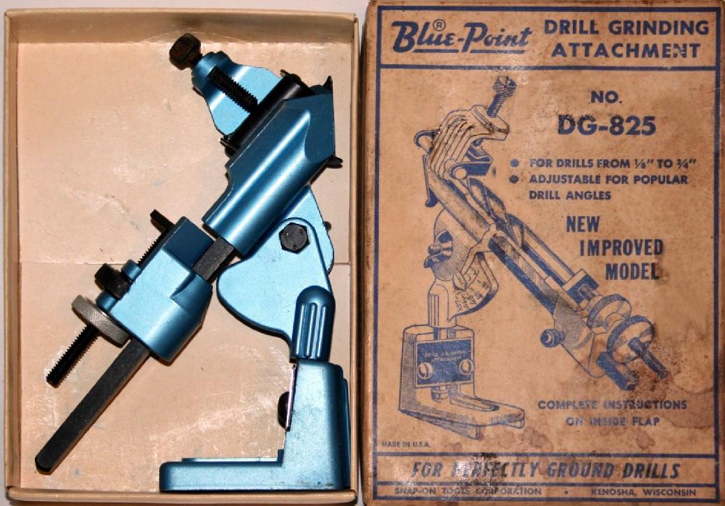

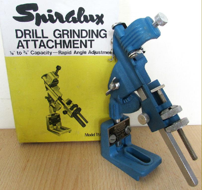

More recent models, from the late 1950s onwards, include the English-made Picador and two another almost identical die-cast examples, these currently sold in the UK as the "Draper" and "Spiralux" - the latter marketed for many years in the United States as the "General" and "Blue-Point" (the latter a lower-cost branding of Snap-On). It is almost certain that the unit has also been sold, and continues to be available, in various unbranded or oddly-named forms. All the American types appear, apart from their price, to have been identical and are often discovered (as are other brands, in other countries) complete with their original box and in almost unused condition….
Although the "General", "Blue-Point", "Picador", "Draper" and "Spiralux" all work (or fail to work) in exactly the same way as the older types, they look almost toy-like in their construction and compare badly to the all-steel and well-engineered original. However, when employed skilfully - and with a full understanding of the principles involved - excellent results can be obtained, though it is all too easy to make a complete hash of the job and give up in despair.

The drill grinder branded for sale in the USA as the "General" - identical models being sold in the UK as Picador, Draper and Spiralux
An unused "Picador"
The "Spiralux" - identical to the "Picador" and "General"

Atlas Drill Grinder Attachment
