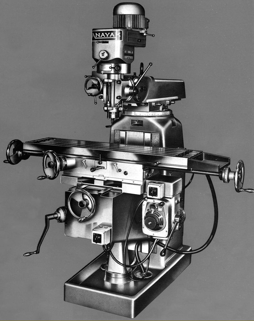

Anayak Type  FV-2: identifiable by a third (forwards-facing) handwheel to drive the table.
This example is an FV-2U "Universal", fitted with a swivel table, and as made during the early 1970s

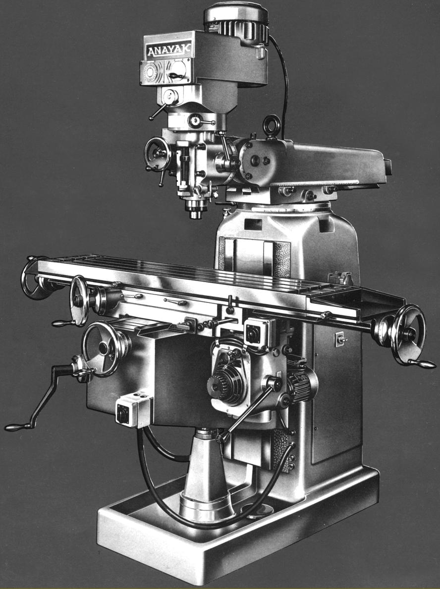

Anayak FV-2 as made during the 1980s

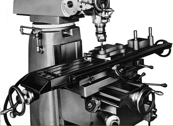

FV-1 fitted with an O.P.L. optical co-ordinate reading system being used for precision boring

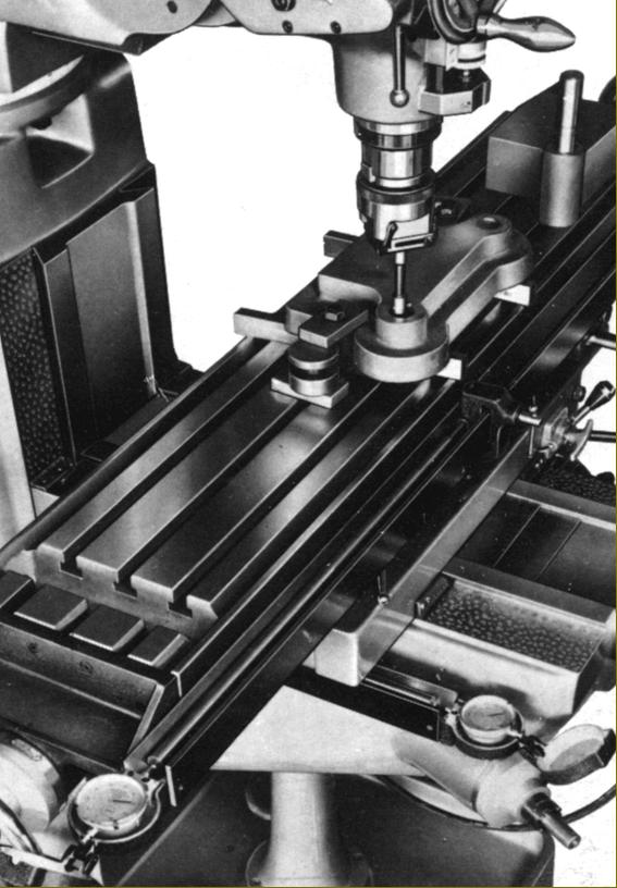

As a cheaper alternative to an optical system (and before the advent of  digital readouts) the fitting of dial-indicators combined with length bars (the latter can been seen sitting in holders alongside the saddle table ways) was considered a highly accurate if rather fiddly and time-consuming was of setting up precision boring jobs and working to exact lengths

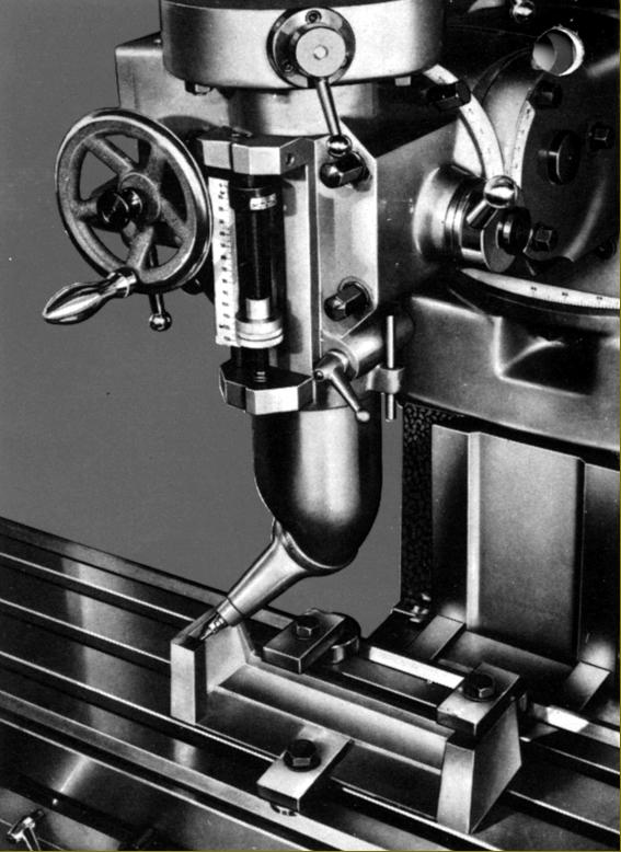

A straight copy of the very useful and sought-after Bridgeport "Quillmaster" all-angle attachment

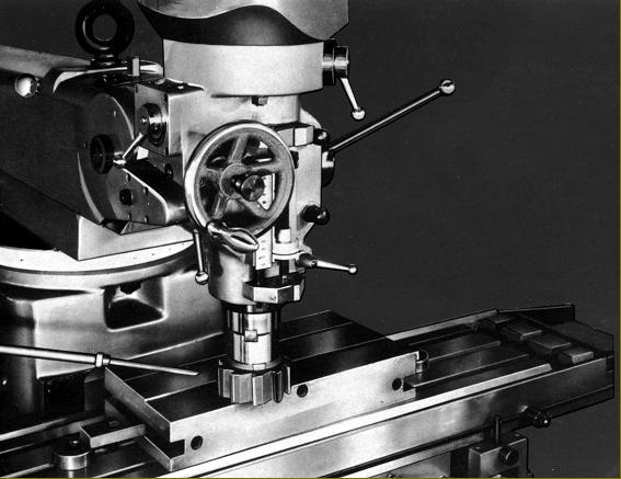

Side-and-face cutter being used at an angle
