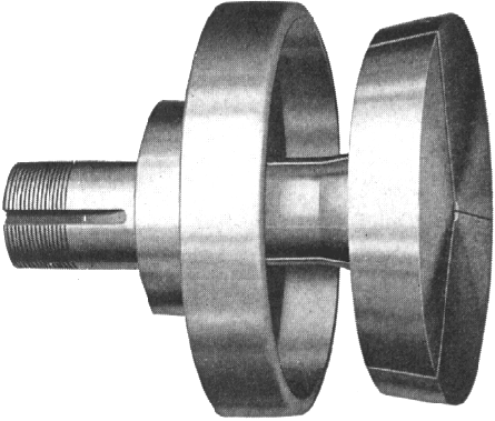

"Step chuck" with its external closing adaptor.
Step chucks were used to hold diameters larger than the headstock spindle would admit. They were made of cast iron and  supplied with a 1/4" hole drilled through the centre.
To use them, the face was turned out to a suitable depth and diameter to accommodate the workpiece, which was then tightly gripped as the collet was drawn back against the closing ring. They were made in 2" and 4" diameters for both the 5/8" and 1" capacity headstocks.

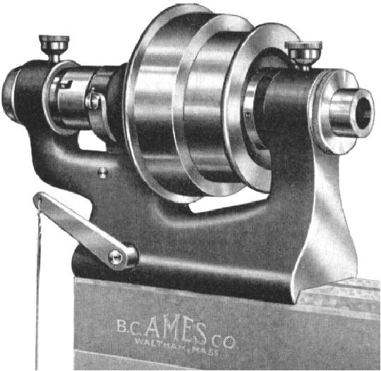

The Three-bearing, 2-step pulley Headstock was designed for production work. An extension at the left-end of the headstock carried a third bearing which supported an integral, quick-action collet opening and closing device.
The device was intended to overcome the inherent tendency of collets to draw work backwards when they were tightened, making it difficult to obtain exact depth setting on repetition work. In this design the collet remained "stationary" whilst, ingeniously, the headstock spindle moved forwards and backwards to tighten and release it. The mechanism was foot-operated, so leaving the operator's hands free to manipulate the compound slide rest, or other attachments, and feed material into the collet.
2-step pulleys were also used on other examples of precision bench lathes adapted for production work, including those by
W.H.Nichols and Bausch & Lomb

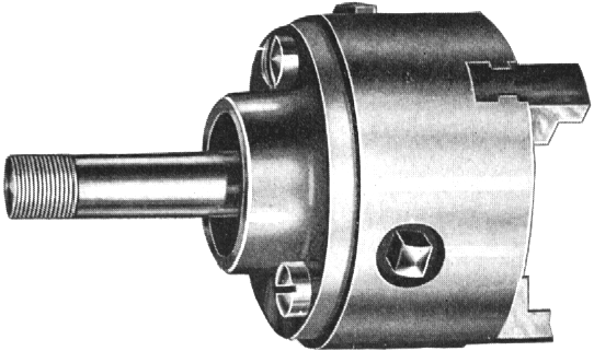

3-jaw chuck showing the backplate with its tapered seat which drew onto the 4 degree taper on the outside of the headstock spindle.

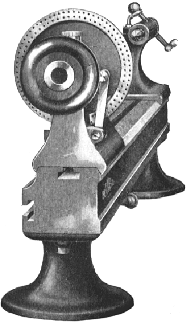

End view of bed showing the double ring of 60 and 72 indexing holes on the spindle-pulley flange.

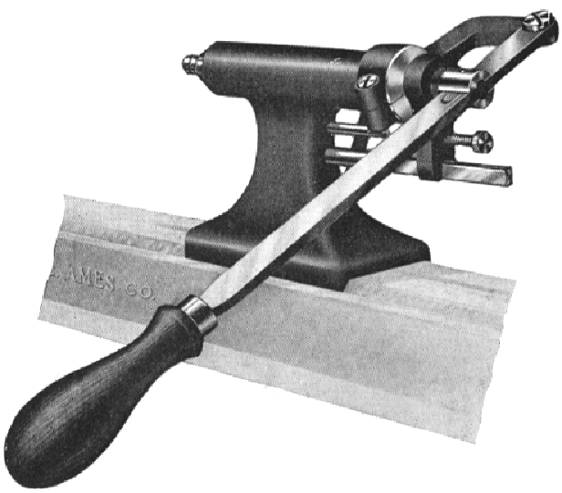

A common accessory on high-class bench lathes - a lever-action
tailstock fitted to a screw-operated cross slide.

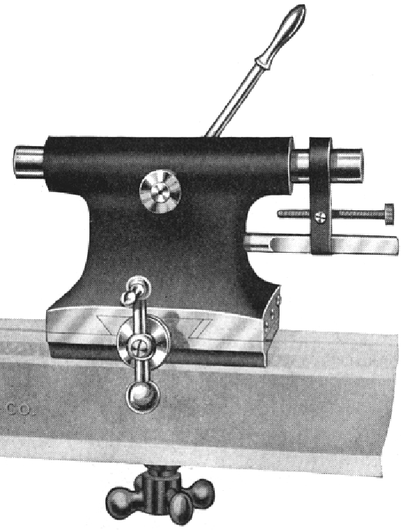

A standard tailstock with lever control of the 3" travel barrel - by far the best way of feeling what is happening to small drills, reamers and taps, etc. The long handle multiples the reaction of the tool to its job and so gives vastly superior control in comparison with a screw-operated feed.
