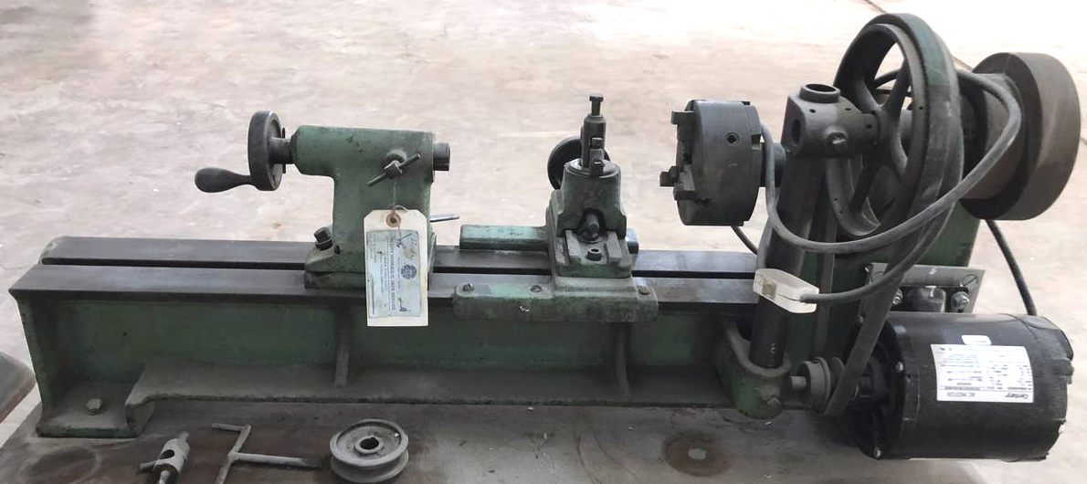

What must be the earlier of the two lathes discovered was driven by what, at first, appears to be a simple home-made countershaft using a single tubular or bar support. However, a closer examination reveals that its appearance (and the shape of the boss supporting the top bearing bracket) mirrors that of the leadscrew drive-gear housing and so is a proper factory-made job. With a single central bearing holding a shaft with the driven pulley at one side and the drive at the other, this was a good example of economical if rather prosaic engineering. The second lathe was fitted with a more conventional arrangement with the short, final-drive flat belt running from a countershaft immediately behind the headstock. Like the South Bend 9-inch "Workshop" lathe the initial drive from motor to countershaft was by a V-belt from a V-pulley on the motor to a flat pulley on the countershaft. However, as the countershaft flat pulley is rather small in diameter (and needs to be much larger for an effective drive), it is doubtful whether this was an original arrangement. If any reader has another machine, or paperwork concerning by the Allen or Acme Electric & Equipment Company, the writer would be interested to hear from you.
What might be the earlier of the two discovered Allen Electrical and Acme Power Equipment lathes
