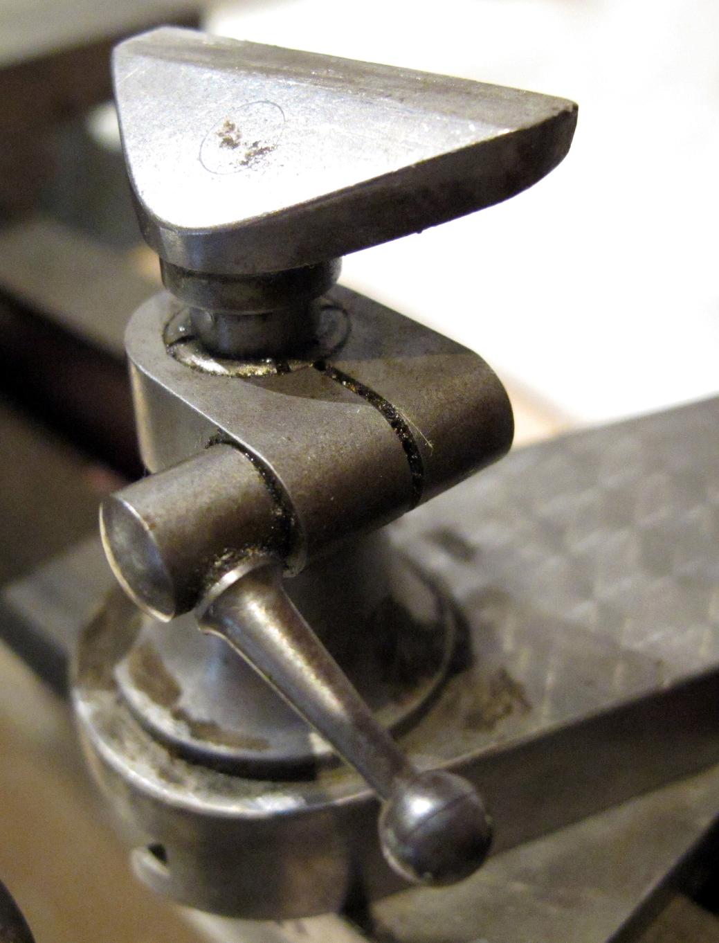

With its flat top and bevelled edges, the bed of the Allanson followed established WW watch-lathe with the headstock and compound slide rest being located on the bevels. The headstock was held in place by a full-length T-headed bolt (the socket head of which could be reached through the bed foot), and the compound slide assembly by the usual through stud with an edge-knurled handwheel. However, the tailstock location differed,  combined locating and clamping plate being used that bore against an angled surface inside the gap between the bed ways. The plate was held in place by a single screw that could be adjusted to allow the clamp lever's locking position to be set correctly. Locked by tightening a long split in the casting, the barrel took a No. 0 Morse taper, with self ejection by the feed screw, this being equipped with a zeroing micrometer dial of the same design as used on the compound slide rest. On some examples the tailstock casting was cut away to reveal a barrel with ruler scale graduated in inches.
Running in adjustable tapered bronze bearings, the 0.4" bore, double-cone hardened and ground headstock spindle carried a 4-step V-belt pulley for 1/4" wide belt that, together with the 2-step drive from motor to the neatly-constructed cast-iron countershaft, gave a range of 8 speeds from approximately 200 to 3000 r.p.m. Instead of using the expected wick-feed oilers to provide a steady flow of clean lubricant into the spindle bearings, the units fitted were merely dust caps with a straight drilling through their base.
Fitted with an enclosed cross slide that gave complete protection to the cross-feed screw, the compound slide assembly had the usual type of long top slide (with an unusually generous 4.5 inches of travel) but with the feed screw running along the forward edge and completely exposed. The small micrometer dials were in brass or bronze and locked by a second, full-circle wheel that pressed inwards without disturbing the setting - both elements being machined with a narrow band of beautiful, old-fashioned convex knurling. "A" and "B" lathes were supplied complete with a simple hand T-rest, compound slide assembly, catchplate, centres, collet draw tube, chuck backplate, a countershaft unit with two V-belts and a motor pulley. It's also likely that a 2-way tool post and faceplate would have been supplied, though the latter was unusual in having circles of plain rather than tapped holes.
