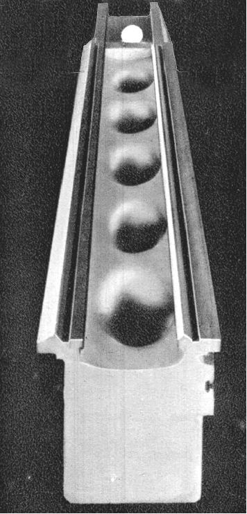

The Alfeo lathe had an enormously deep, 375 mm wide and rigid bed. Heavy transverse walls braced the bed with the gaps between running through to large elliptical holes at the rear for swarf clearance.
