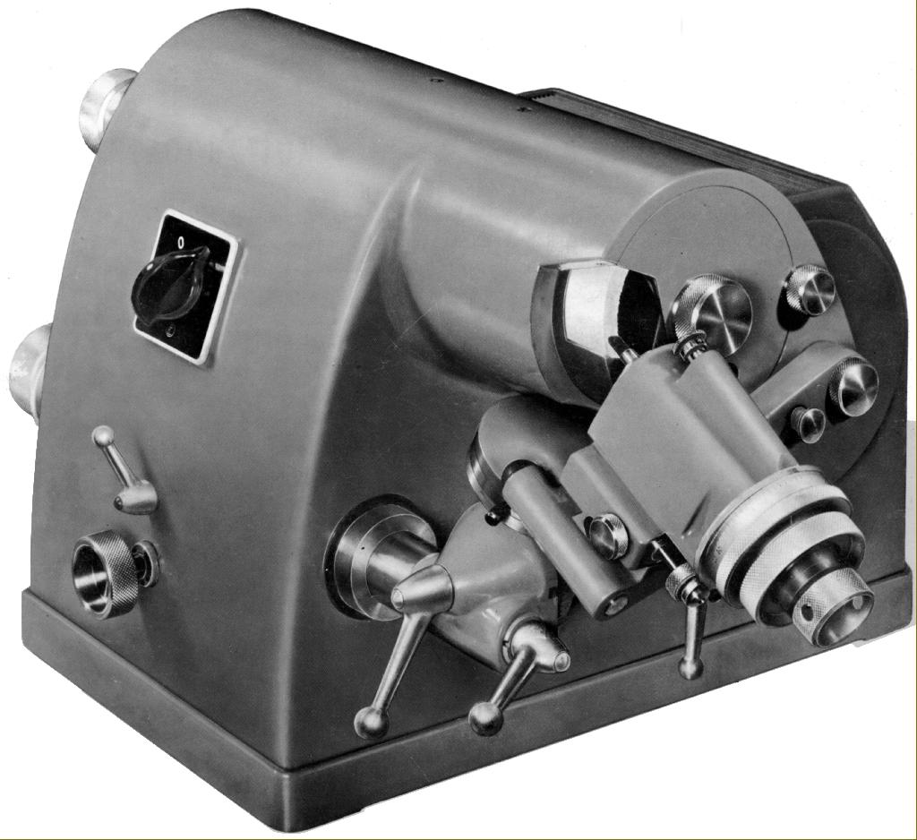

Deckel/Alexander Model S0 tool and cutter grinder.

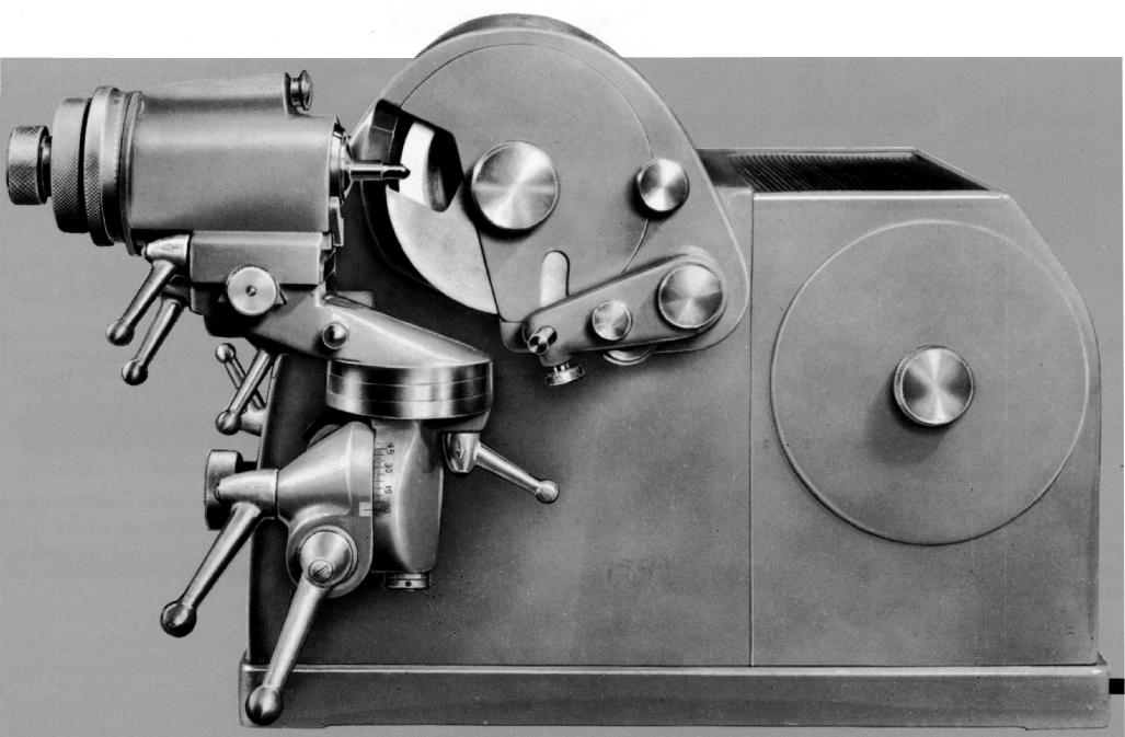

A simplified version by Alexander for sharpening engraver D bits

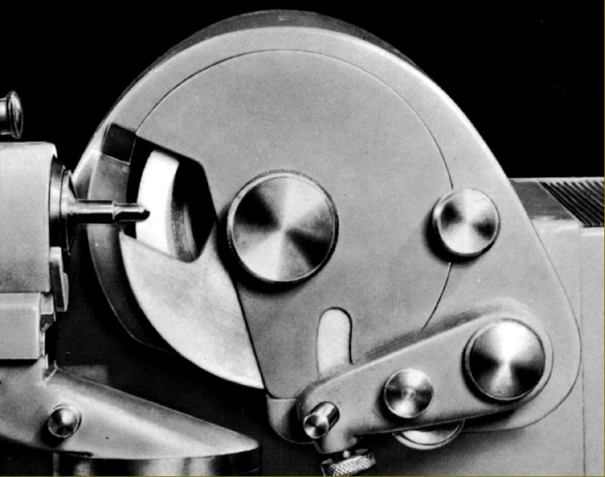

Another view of the Deckel/Alexander Model S0
