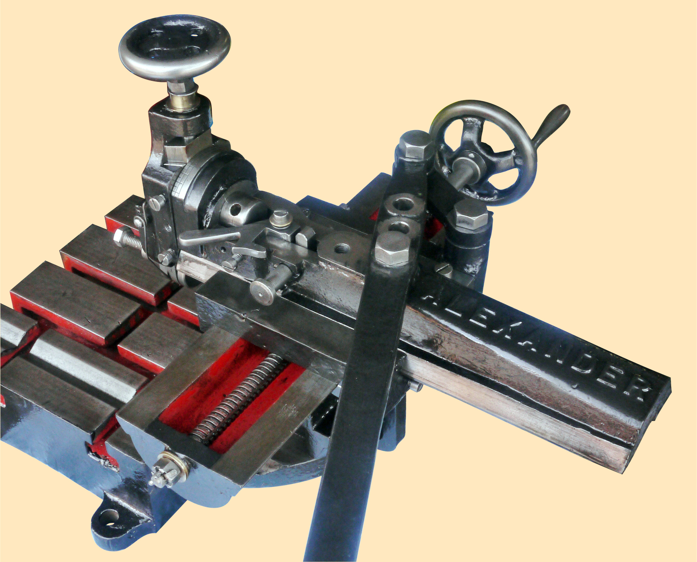

In addition, with limited room under the cutter, there was only just enough space to fit a small vice. Even so, on all machines, the table was of a generous size and provided with numerous heavy-duty T-slots - though the base on the Alexander was much superior having over three times the depth and a machined vertical surface at the front that allowed the operator much greater scope for inventive mounting.
Fixed on the Rapid-Lime and Robblak, on the Alexander the complete upper assembly, consisting of a  6-inch travel ram and 8-inch travel cross slide, could be slackened from the base and rotated through any desired angle, an engraved scale on the base showing the setting. At the front a pivot bolt located the unit while at the back a cast-iron "hook" anchored it in place, the rear of the baseplate being curved and cast with a groove into which the hook engaged.

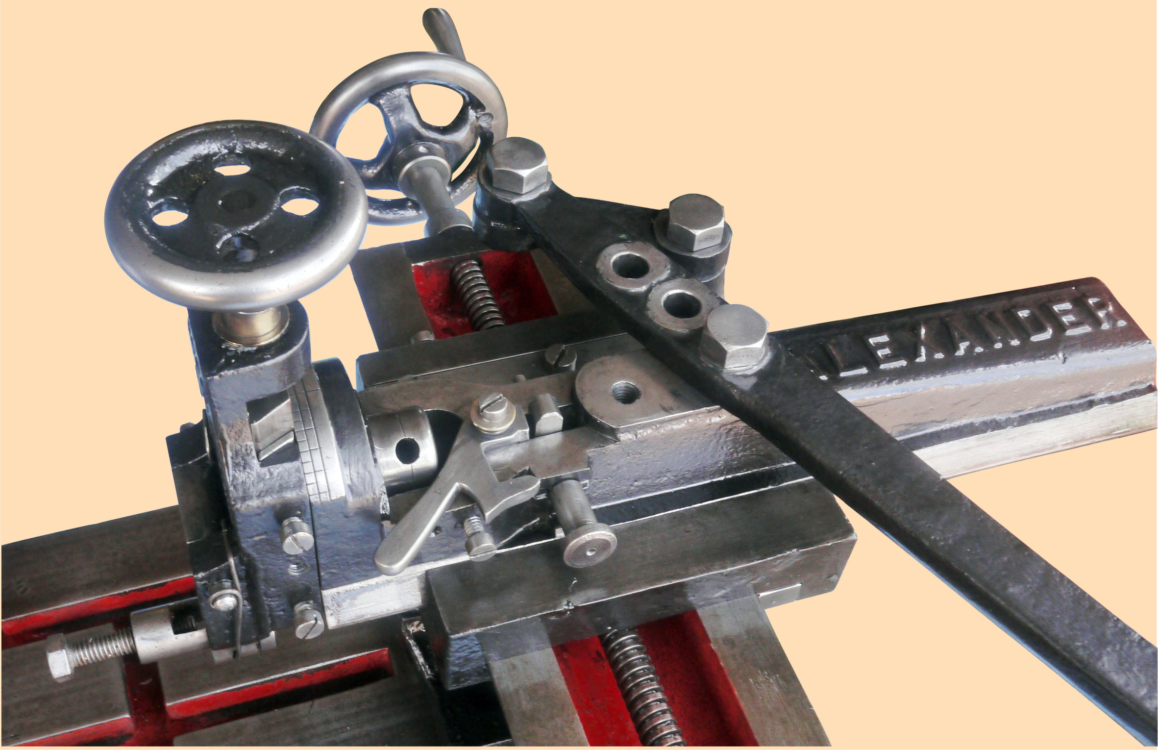

One featured shared by all makes - and patented on the Alexander - was an automatic, reversible table feed. This mechanism consisted of a star wheel (mounted on, keyed to and so able to slide along the hand-feed screw) that engaged with a pawl that turned it tooth by tooth. On the Rapid-Lime and Robblack a simple stop was provided, in the form of a pin that could be inserted at either side of the pawl, and so reverse the feed direction. However, the Alexander had a more developed system that was not only reversible but able to vary the rate of feed. A cross-pin, occupying a single hole, was made eccentric so that, when turned, its point of engaging the pawl varied from tight to slack. At the highest setting the pawl was disengaged completely and the operator could apply the feed by hand; as the pin was turned and the pawl lowered, a point was reached where every other tooth was picked up (so giving a slow feed) and, upon lowering further, drive took place on every tooth. Instead of the two-hole reversing pin, the Alexander used a pivoting latch plate, formed with a handle, that "
has two projections either of which may engage beside the top of the pawl so preventing it turning from one side to another." The photographs below make the arrangement clear and details are also included in the patent documents. Unfortunately, although details of the variable-speed mechanism appear in the patent, the system is not fitted to the machine below.

The well-made and interesting Alexander hand-operated shaping machine
The base on the Alexander much superior to those on the Robblak and Rapid-Lime having over three times the depth and a machined vertical surface at the front that allowed the operator much greater scope for inventive mounting.
As on many other hand-operated shapers, the makers provided alternative fulcrum points
Careful work by the pattern maker ensured that the Alexander name was crisply displayed
Instead of allowing the tool-slide to drop back under gravity at the end of the return stroke, on the Alexander an "assistance spring" was provided
Handy for research, the manufacturing date and patent number were cast into the front face of the tool slide
The V-way tool-slide could be rotated on the end of the ram
Front pivot bolt, on which the carriage and ram assembly rotated, and the engraved degree scale
Lever to select carriage feed direction--position 1
Lever to select carriage feed direction--position 2
Underside of carriage - the power-feed "star wheel"
Power feed star-wheel engagement pawl
