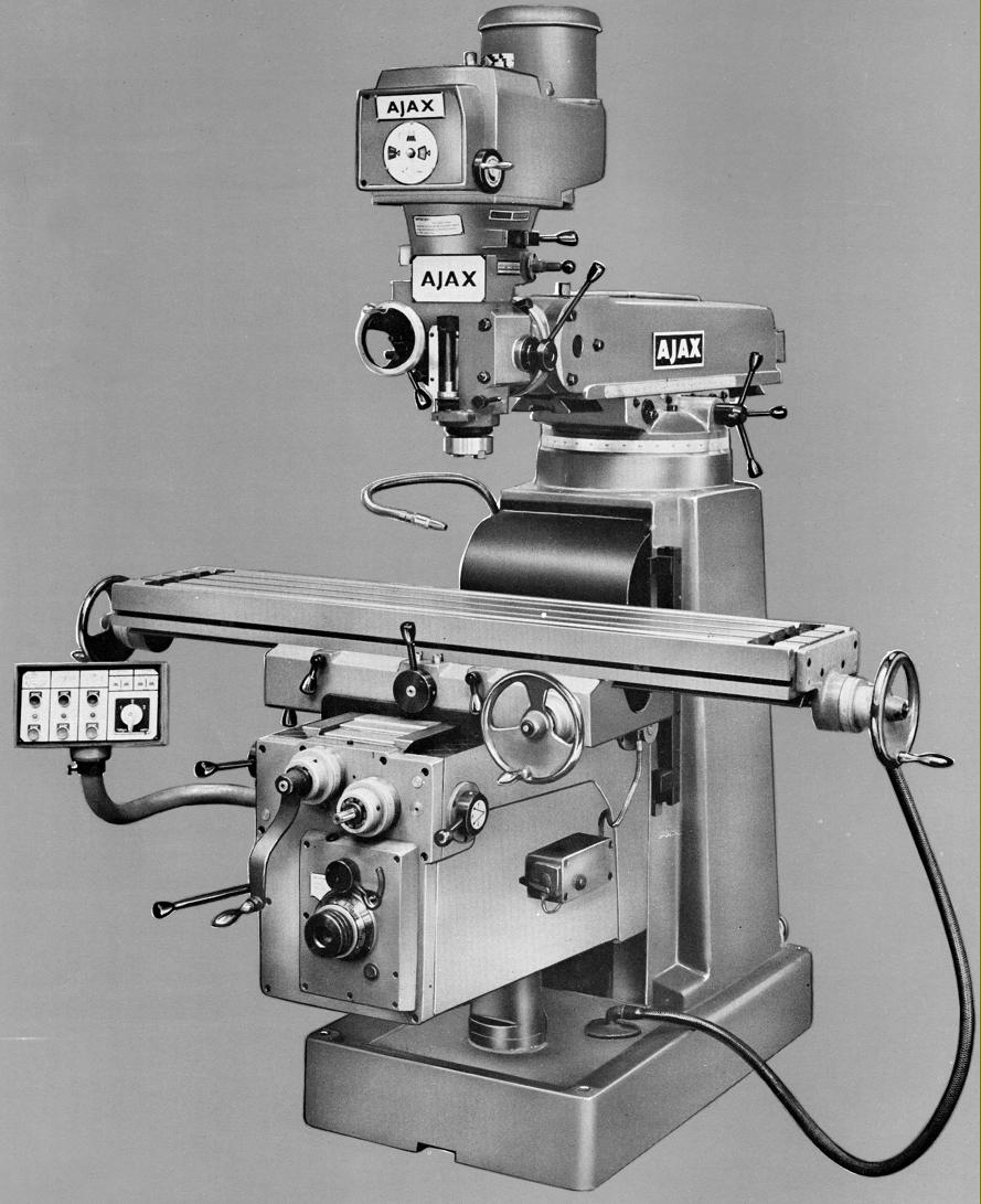

Ajax AJT.2 Mk. 1 Spanish-built vertical miller. Easily recognised by two parallel rows of 4 push-buttons controls on its front face, the first vertical head used was only listed for 2 years before being replaced by the simplified and much-improved Mk. 2. Fitted with either a Bridgeport type R8 or an ISO 30 socket the spindle had 5" of travel under the control of both a fine-feed handwheel and a quick-action drilling lever and was also fitted power feed that gave 3 rates of 0.0015, 0.003 and 0.006" per revolution Driven by a 2 h.p. 3-phase motor and equipped with a toothed-belt driven reduction mechanism, the head had 8 speeds: 49, 85, 145, 260, 450, 780, 1330 and 2400 r.p.m. A single table was listed of 48" x 9" with 35.5" on longitudinal travel, 16" in traverse and 16" vertically. Power-feed to the table was an optional extra (though all examples found so far have it fitted) that had 12 rates from 1/"" to 7.5" per rev.. The maximum distance between spindle nose and table was 18.5", the full clearance between spindle axis and the inner face of the column was 30.5" and the minimum 5.1"

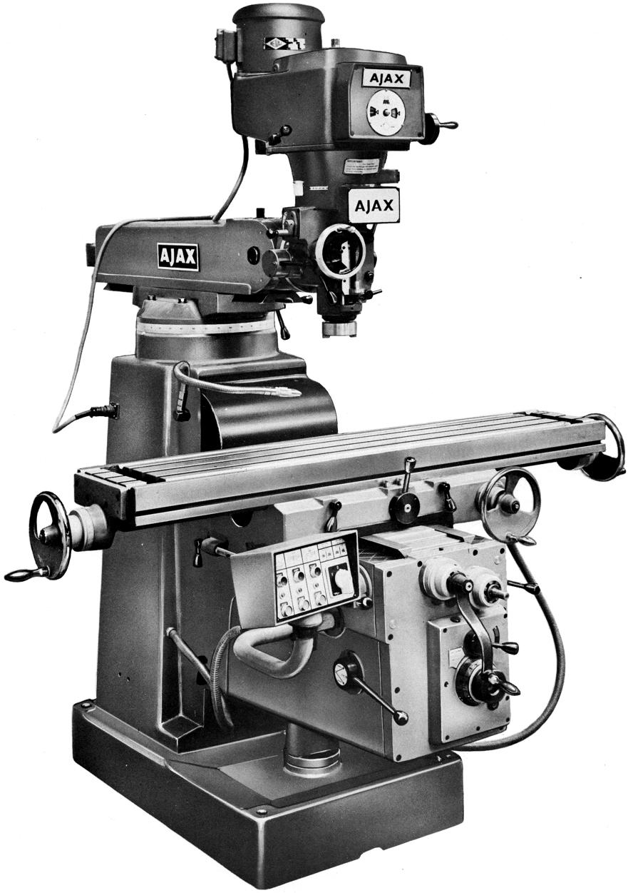

Ajax Mk. 2 AJT1, AJT2 and AJT3 Turret Milling machines. Identical to the Mk. 1 in respect of the main column and table the Mk. 2 version had a much-improved and easier-to-operate vertical head that lacked the distinctive row of 6 push-buttons controls on the front face. At the same time a number of larger models were introduced, all the same apart from table size these were Spanish-built and based closely on the Bridgeport Series 1. Later models had safer, full-circle handwheels
Ajax AJT1, AJT2 and AJT3--left-hand view

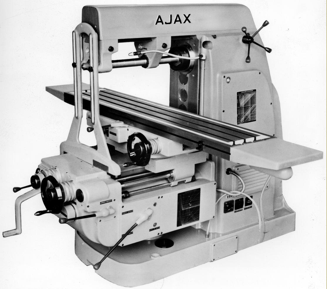

Ajax AJ7 and AJ8 horizontal. These were very neat, popular machines of which several thousand must have been sold. The motor was mounted neatly inside the cabinet base and drove up to the spindle using V-belts. An even larger version, the AJ9 was also listed.
