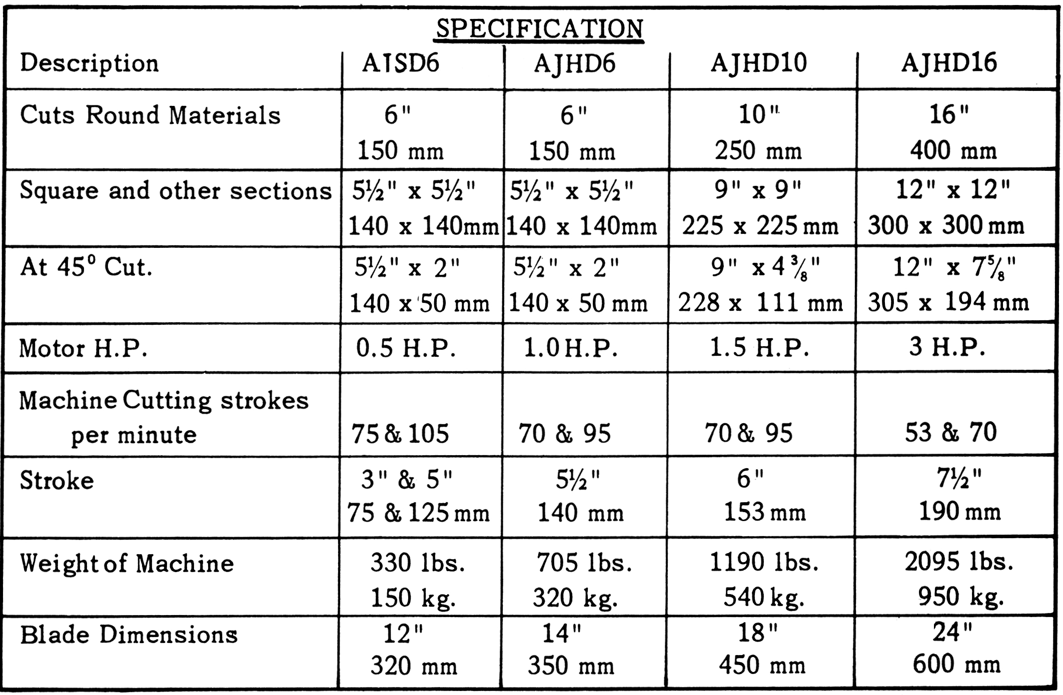

Built during the 1960s and 1970s in a range of four sizes, Ajax mechanical hacksaws were typical of the Company's offerings being of a good speciation, well built and very competitively priced. Who manufactured the machines came is not known, but as most other Ajax offerings at the time came from within in Eastern Europe - for example as Bulgaria, Romania and Czechoslovakia - that is where they are likely to have been made.
Able to cut round material 6 inches (153 mm) in diameter and square and other sections of up to 5.5" x 5.5" (140 mm x 140 mm) the two smallest models the AJDS6 and AJHD6 were of the same mechanically design. However, while the AJDS6 was intended for light-duty use and fitted with a 0.5 h.p. motor, machine speeds of 75 and 105, stroke rates of 3 inches and 5 inches (75 and 125 mm) and took a 12-inch (320 mm)  blade, the AJHD6 was intended as a more heavy-duty type and supplied with a 1 h.p. motor, machine speeds of 70 and 95, a single stroke rate of 5.5 inches (140 mm) and a 14-inch (350 mm) blade.
Intended for continuous industrial use, the AJHD10 and AJHD16 were much more powerful machines, the former with a 1.5 h.p. motor, speeds of 70 and 95, a stroke of 6 inches (153 mm) and an 18-inch (450 mm) blade. With a stroke of 7.5" (190 mm), the AJHD16 had a motor twice as powerful, speeds of 53 and 70 and took a 24-inch 600 mm) blade.
The masses of the machines are a clear indication of their expected use: The AJSD6 weighed a rather light 330 lbs (150 kg); the AJHD6 705 lbs (320 kg); the AJHD10 1190 lbs (540 kg) and the massive AJHD16 nearly one ton at 2095 lbs (950 kg).
All models incorporated an adjustable rate of down feed and a simple, automatic motor cut-off when the job was complete. Included with each new machine was a no-volt safety starter, coolant pump, tank, setting bar and a vice, able to be set at 45 and 90 degrees, that locked down into abutment slots.
