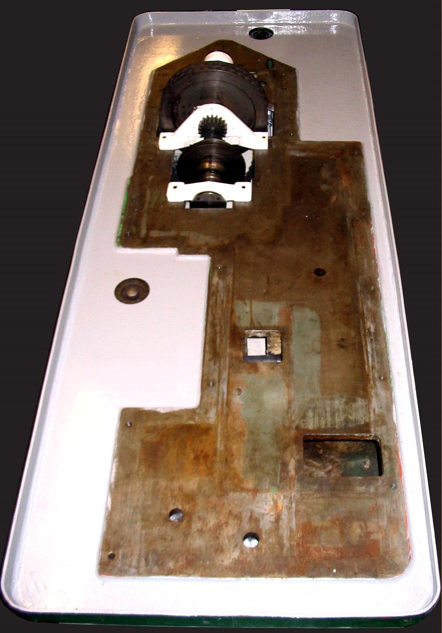

Baseplate of the smaller Universal machine with the milling machine countershaft unit in place
Auxiliary base in place. This was used as a mounting for the grinding machine and lathe and was bolted to the main base with hex-headed socket screws. Fabricated, like the main base, from heavy steel plates joined together with full-length fillet welds the underside edges, and all other mating surfaces, were planed flat.

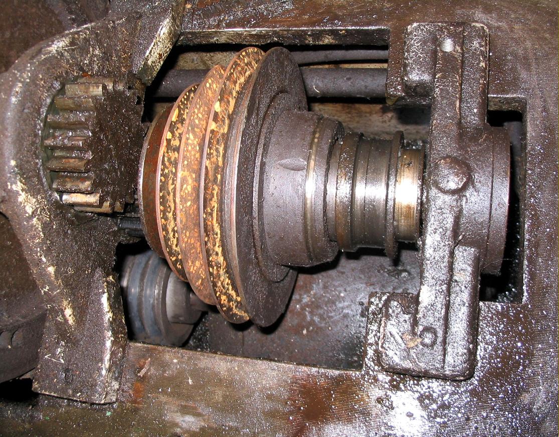

Countershaft assembly from the milling-machine end of the base
Next stage in assembly: the fabricated auxiliary section to carry the grinder and lathe is bolted in place
Part of the fabricated auxiliary base showing the full-length welds and a section of planed edge
Countershaft assembly from the lathe end of the base
