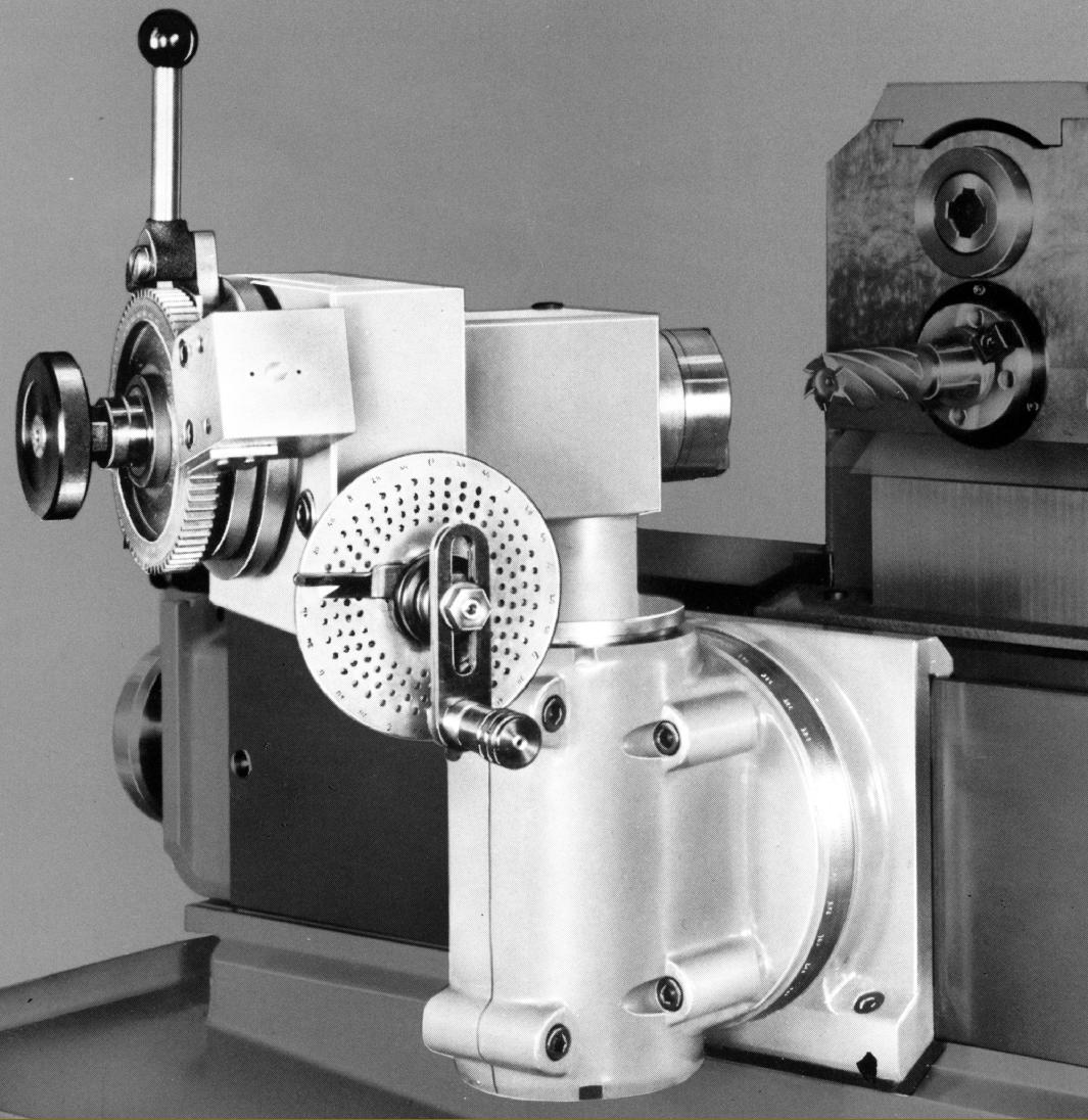

A more complex dividing head was also available - the Universal Inclinable. With the same range of nose fittings as the standard head, this 4-inch (100 mm) centre height version had a body that could be rotated from horizontal to vertical. A 24-hole indexing plate was fitted as part of the standard specification, as was a set of three indexing plates.

Power-driven Inclinable Universal Dividing Head being used in conjunction with the Universal Milling Head.
