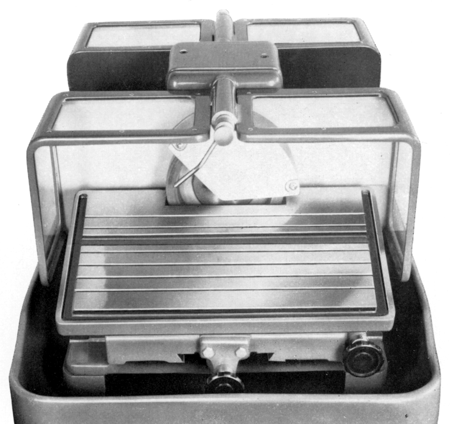

Mk. 3 Abwood tool grinder. This version, current from 1949, was finally given a name and a type designation - the "Concentre", this being available as two models, the C.G.2 and C.G.3, the former with 8-inch wheels and the latter with 12-inch.
Head unit of the Mk. 3 "Concentre" Abwood tool grinder
Mk. 3 table and protractor
Mk. 3 wheel assembly
