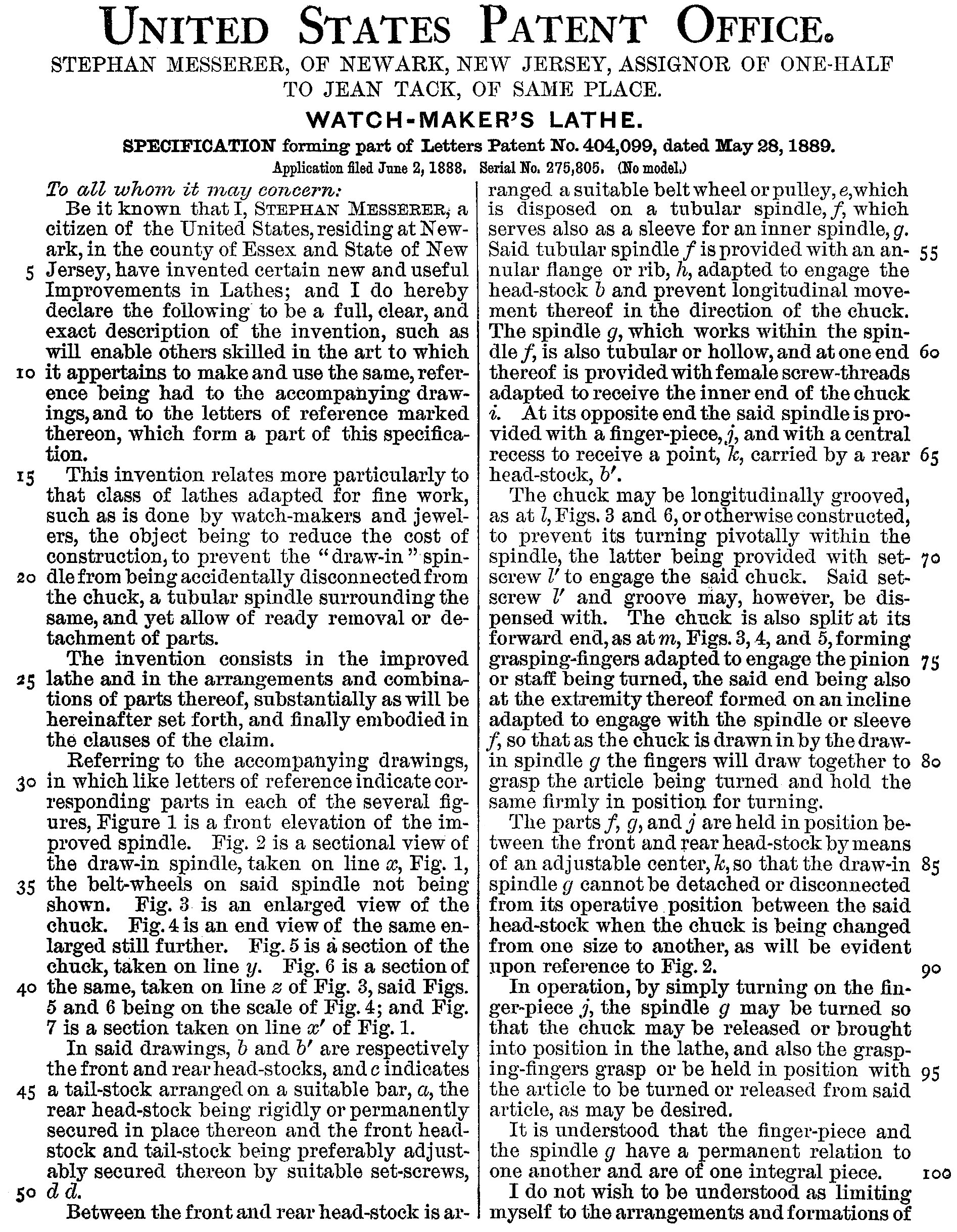

Turning to Mr. S. Messerer, all that he proclaimed in his patent was the idea of a Moseley-like headstock spindle and pulley (e), secured to the bed (a) of a pair of turns on a post (b) that could be slid on and off as required. The solid, drawn-in bar with a thread on its end that secured the collet (x) was bored in the handle end (j) with a recess that engaged the point of the slide-in-and-out centre bar (A) of the turns' solidly fixed tailstock (b1).
Messerer's - some 31 years later - seems to be the first to do this. However, one year earlier, in 1888,a  Horace Moseley of Elgin did patent an adjustable length stop to be used in association with a draw-jn collet, and in this, he refers to established and "usual" parts as though these would, by then, have been in almost everyday use.
Amusingly, the patent by Messerer contains a comment in regard to preventing the collet from turning when tightened or loosened - or not bothering: "
The chuck may be longitudinally grooved, as at I Figs.3, and 6, or otherwise constructed to prevent it turning pivotally within the spindle, the latter being provided with setscrew l1 to engage the said chuck. Said setscrew l1 and grove may however be dispensed with."
