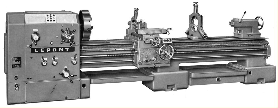

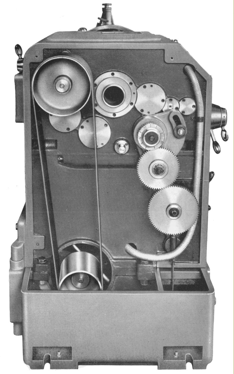

Leopoldo Pontiggia Lepont H-200
Smallest of the Company range was the 8-inch centre height (16-inch swing) Model H-200, a machine similar in capacity to the Colchester Mascot 1600 and available with between-centres capacities of 40 or 60 inches - the shorter bed version listed as weighing 3250 lbs (1474 kg) and the longer 4000 lbs (1814 kg). Enormously deep and strongly cross braced, the bed was available either straight or with a gap - the latter fitting allowing work up to 12.125-inch diameter to be turned
All-geared, the headstock held a D1-8" Camlock-nose spindle running in taper roller bearings with a rather limited through capacity of  1.656 inches. Powered by a 2-speed 2.8/4 h.p. motor,  sixteen spindle speeds were available that spanned 25 to 1500 r.p.m. However, for heavy-duty work the makers also offered to supply and fit a more powerful motor, suggesting that a single-speed 7.5 h.p. would be sufficient. Spindle control was by the "third-rod" system with a control levers pivoting from both the right and left-hand faces of the apron.
Completely enclosed and with control by rotary levers, the screwcutting and feeds gearbox fitted for the American market offered 63 inch pitches from 2 to 75 t.p.i. and 138 changes of power feed from 0.001 to 0.118" per revolution of the spindle with the cross-feed rate set to be twice as fine (0.0005" to 0.059").

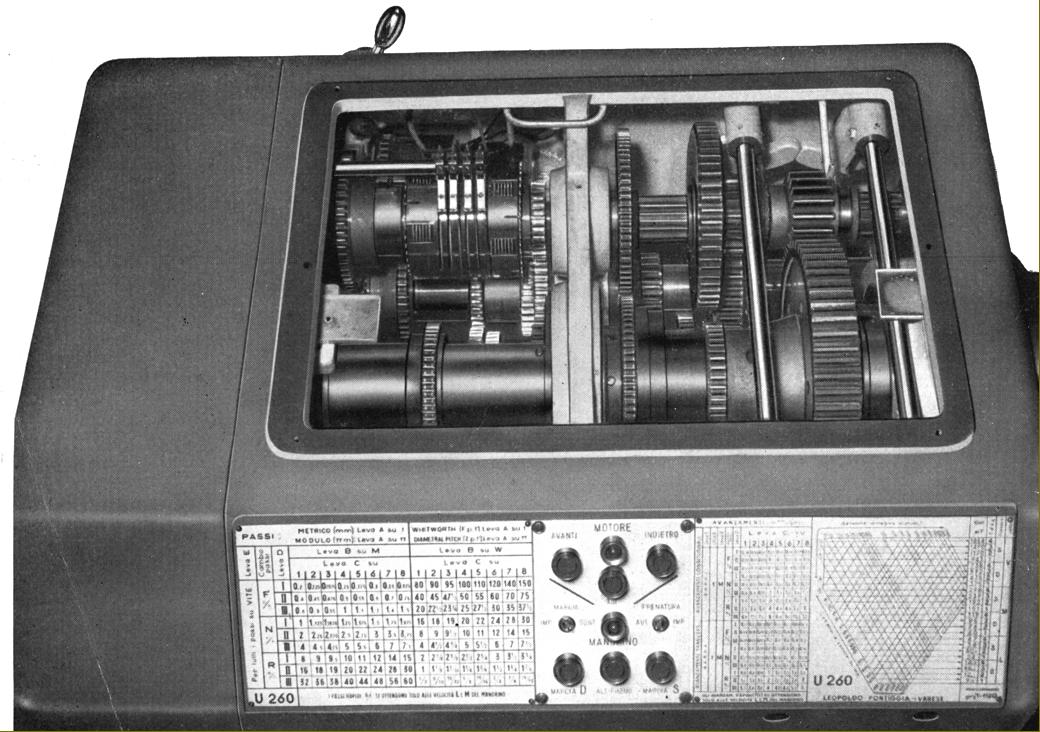

With centre heights of, respectively, 10 and 12 inches respectively, the U-260 and U-300 were of identical appearance though different capacities, the larger of the two being intended for the lighter turning of larger diameters. Machined from a high-quality, well-aged iron casting the bed was a double-height type with the flat and V-ways ways for the tailstock being set above those for the carriage. This arrangement allowed both the fitting of full-length chip guards to the carriage ways and, as the tailstock ways stopped short of the headstock, the difference in height between the two sets of ways allowed the provision of a fixed "faux" gap that reached 13.8" out in front of the chuck. Front and back walls of the bed were braced by strong elliptical webs, their wide, open centres allowing the free flow of chips and coolant. Instead of a full cabinet stand, the weight of the lathes demanded the provision of cast-iron plinths, one under the tailstock end of the bed, the other in the middle.
Driven by a 20 h.p. motor using a very wide flat belt, the all-geared headstock held speed-change gears that were all in a chrome-nickel steel, heat-treated and profile ground. Carrying a D1-8" camlock-nose and bored through with a 3-inch hole, the spindle was supported in three roller bearings, two of which were adjustable, and with axial loads taken out against pre-loaded thrust bearings. 24 spindle speeds were provided, ranging from 9 to 1800 r.p.m., with engagement and disengagement through an oil-immersed, multi-disc electromagnetic clutch - the action of releasing the drive bringing into action a powerful electromagnetic brake. Control of the clutches was by push-buttons, these being fitted to the front face of the headstock and, handily, duplicated on the carriage. It was possible to alter the function of the clutches (by a lever at the back of the headstock protruding above its top surface) to give a rapid return of the carriage when screwcutting as well as a quick change of spindle speed when moving from rough to final-finish turning. Lubrication was by a rotary pump, the oil being filtered and its flow able to be checked through a sight-glass.
Completely enclosed and lubricated by pump, the screwcutting and feeds' gearbox was driven by a train of gears that could be set to generate a fine, normal or fast travel of the carriage while also allowing its direction of travel to be reversed. The box was able to generate a total of 288 different pitches (English, metric, module and diametral) without altering either the position of, or replacing, any of the changewheels. A thread-dial indicator was supplied as part of the standard equipment and, to help with the generation of Multi-start threads, the first gear in the changewheel set was engraved with a "multi-start" index ring.
